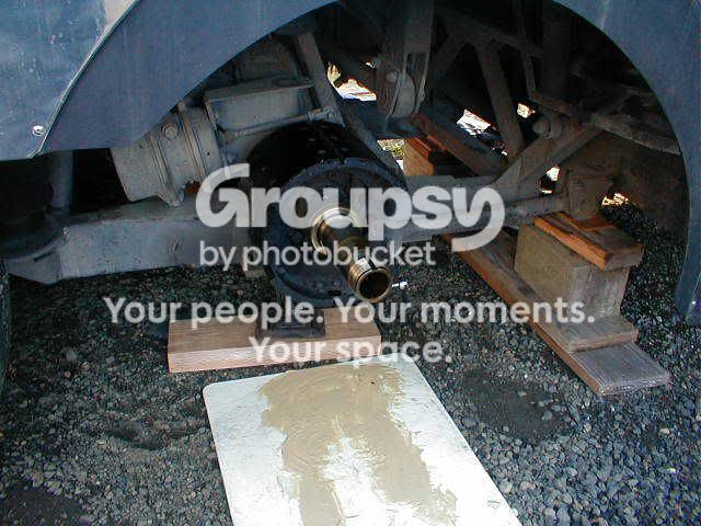

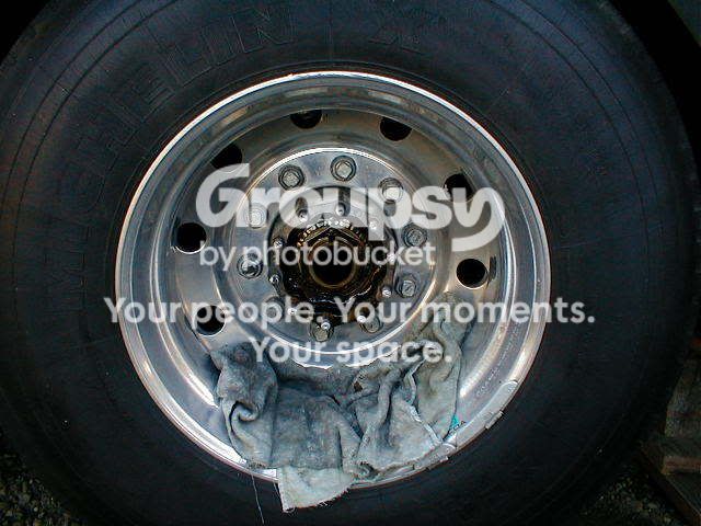

Need a little advice here please. Since doing my wheel seals on the drive axles, the bearings are running a little warmer than before and I'm thinking I may have preloaded them (over tightened). I set them according to the manual which called for torquing to 250 while rotating the wheel (I didn't have a helper either) and then backing the nut off 1 full revolution and retorquing to 50 before setting the locknut. Does that sound about right? Or did I miss something? Any experienced advice will be greatly appreciated. The seals aren't leaking and I don't want to have to do them again Sad. I did figure out what started them leaking in the first place, and it wasn't my fault (honest) Grin
Thanks in advance, Will

« Reply #13 on: February 18, 2009, 11:35:49 AM »
From the belt and suspenders crowd....
If you want to make a mistake, it's better to be a little loose than a little tight, when it comes to wheel bearings.
A little wheel bearing grease to get the bearings started in an oil bath set-up is not uncommon, and many grizzled wrenches report having never suffered a problem due to the practice.
Great pictures, PP!
