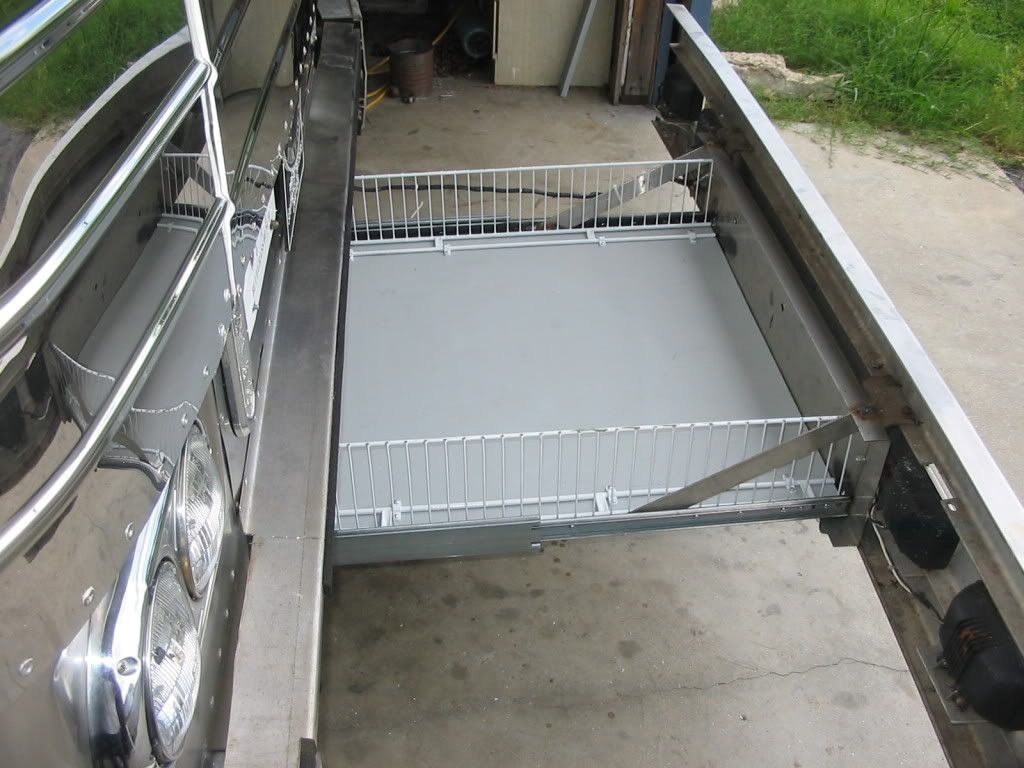

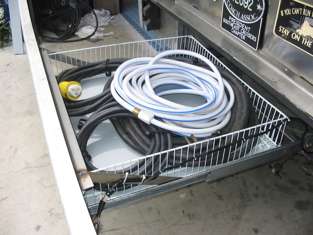

Here is what we did with our spare tire compartment when we quit carrying a spare.  Front of tray is attached to the front bumper.  Jack

Jack - do you have a way to latch the tray closed?  Do you remember what weight ratings the slides are?  That's a really great idea.

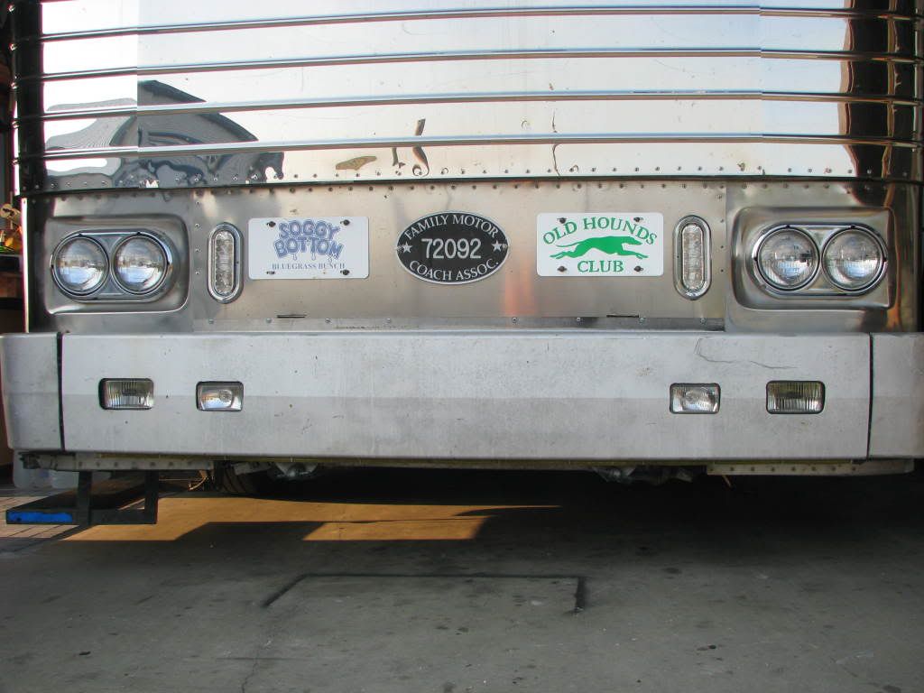

Jack, could You please post a frontal picture, so I can see Your brush guards!  Did You build them Yourself or are they commercial items.  Regards, John
Posts: 2962
BCM Webmaster
« Reply #7 on: April 01, 2009, 01:20:22 PM »
John, those aren't brush guards.  They are a testimony to how nicely polished the stainless is.  The "bars" are the ribs and the apparent space behind the "bars" is the reflected view in the polished metal.
I thought the same thing for a moment.  Then I thought, "I don't remember brush guards on Jack's bus."  So I looked again and figured it out.

Jack,
Again, you have just wonderfully clean coach including this storage bin. Have you many miles on this installation, as My spare tire is filty along with the driver's tool storage area after a trip, with dirt, rain, slop getting into this space.

High Tech, I couldn't remember seeing brush guards at Arcadia but jack is very profilic.  After looking again I can see what You are talking about!  I guess I will never have the ilusion because My stainless is never going to be that bright!  Thinking about that I am not that bright either. Oh well, thanks and best regards,John.
Glenn

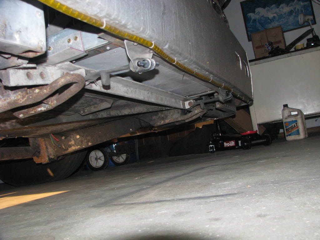

The slides are full extension slides rated for 500#. Here are couple photos showing the 2 latches that are under the bumper. These are the same latches that were used to keep the bumper closed when we still hauled a spare. We have used this for approx. 25,000 miles. I add add piece of SS angle that attaches across the front of the bus and has a foam lined lip the bumper seats against to help keep out rain & debris.  Jack
Here is a photo of the front with the tray closed and latched
