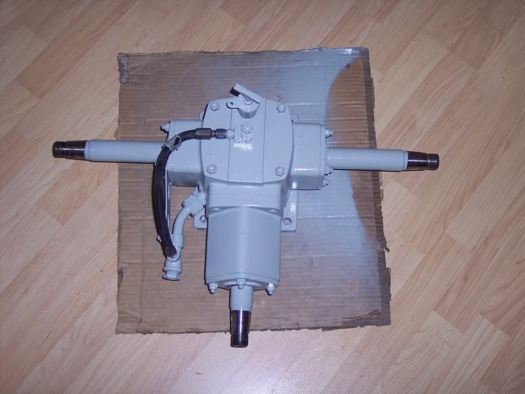

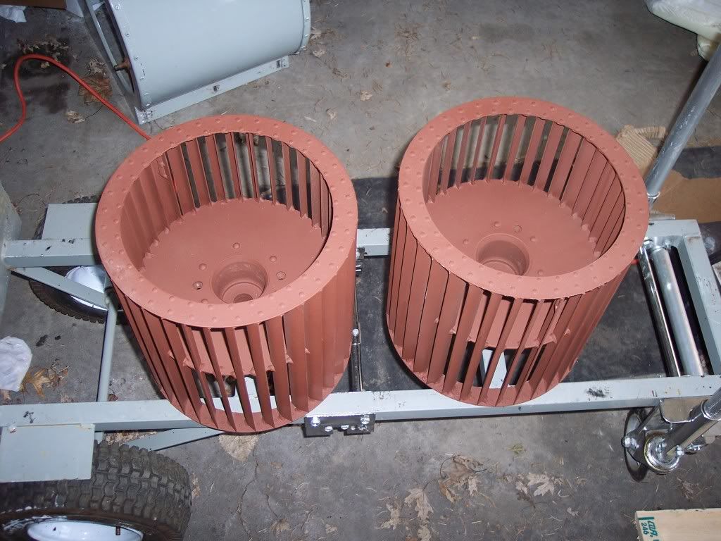

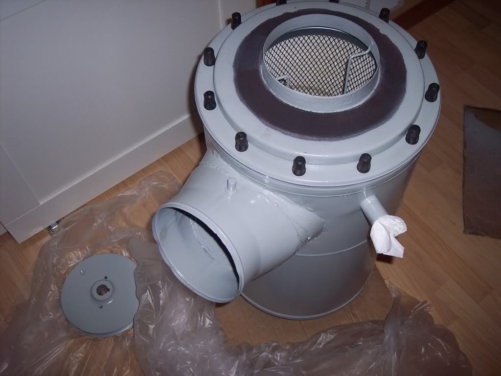

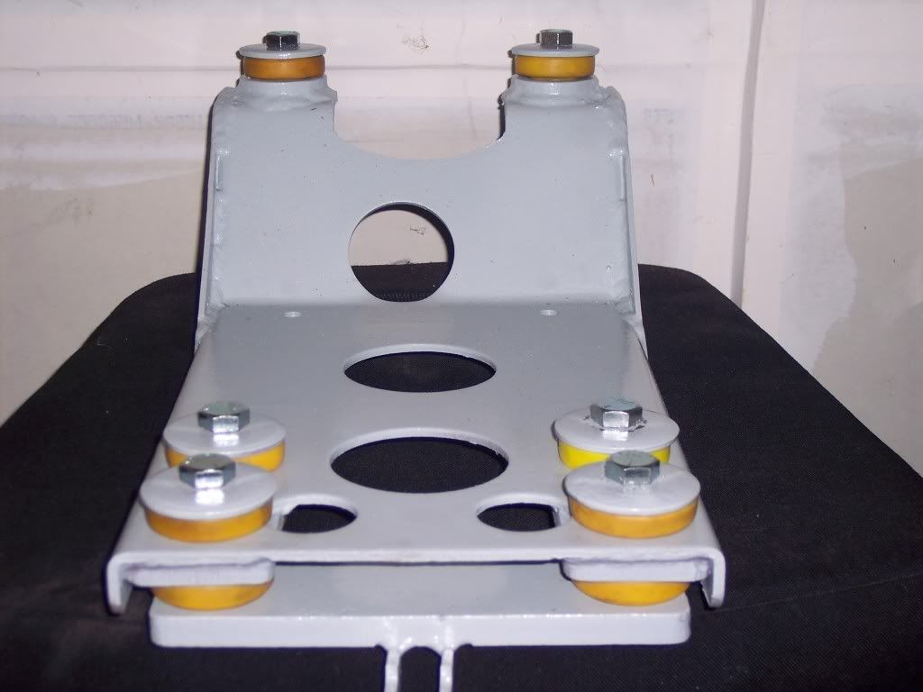

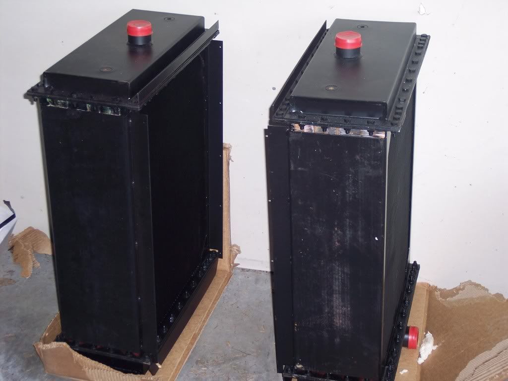

Well here's the list:
New larger Radiators, seals and mounts
I rebuilt my blower gear box with new seals and speedee sleeves
New squirrel cage seals and slightly used scrolls
Hi speed pulley
New rear door seals
New air filter and vacuum gauge
Top radiator strap mounts
new shorter blower gearbox drive belts
Neoprene gearbox saddle bushings
New surge tank bushings (Mazda shock bushing racing red!!)
All new nuts and bolts some stainless, some not
Sandblasted and painted all parts and the whole rear engine compartment.
Thanks for the help through this, especially the Gumpster and Brian Diehl. I am glad you live in Minnesota.
I am trying to attach some photo's using photobucket but so far all it does is get me mad. Well, here goes

A couple more pix.
Hey did I say how much I like Photobucket??? And how easy it is to use? So simple even a dork like me can do it...

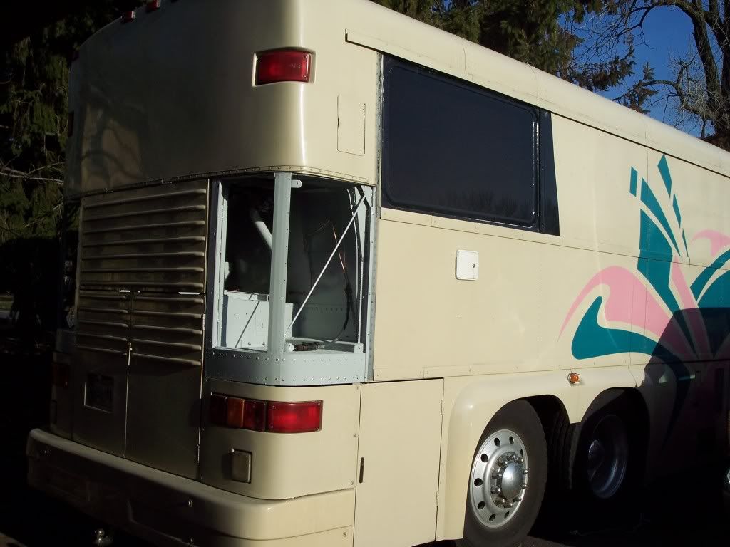

Hey All,
I got her running bright and early this morning. Definitely gonna need the shutterstats working though.
I left it running for about a half hour and she barely raised 100 degrees.
I am not completely done but I can see the finish line...
Thanks to Brian Elfert for the riveter, Gumpy for the tagalong ride to Faribault for parts and Brian Diehl for driving over here last night with no notice just to help out.
I am blessed....
Rick

A diesel engine at idle isn't going to produce much heat.  My engine won't heat up at idle unless I crank the RPMs up with my cruise control.
The best test after you're satisifed there are no leaks is to actually drive the bus and monitor the temps.
