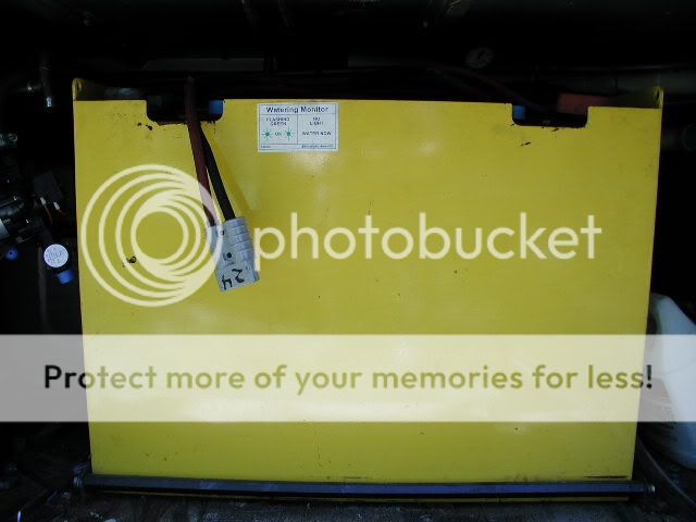

« Reply #18 on: May 18, 2009, 01:38:56 PM »
There's a 24v Hi-Lo battery in my coach. Lots of power in 1 package. If you can find a core you can get it rebuilt for around $800.
 I know a couple of people that use them and are very happy.
