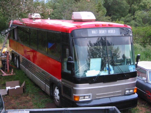

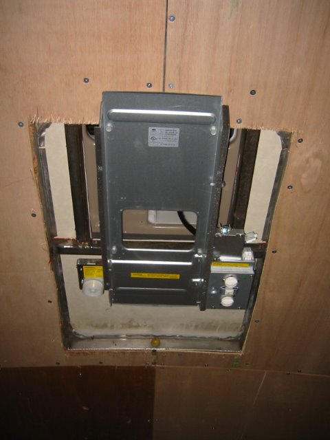

Our bus finally has 2 ugly white boxes stuck on the roof.Took most of last sunday to frame the hatches and skin them over.Still have the wiring,insulation and interior wood to do.Here's outside.
Here's inside

Nice Job bigtim44,
Now it's time to use your bus....No excuses,  May as well go to Disney, your bus is...LOL
I like that RED too....

Yeah... the red paint is kinda bright  Grin I was thinking about putting some stick on graphics over the red to break it up,a buddy of mine can lazer cut them up to 20 ft long.I race a 1930 model A up at bonneville so I could go with the hotrod theme and put some kind of flames on it.

Hey bigtim.  That would look awesome!  Personally, I don't think the air units look that bad...  Beats the heck out of burning up.  Plus, most normal people are not going to look at the top of the bus and say, "he shouldn't have put those ugly air conditioners up there."

I also have no objection to the appearance of rooftop A/C's. I painted mine the same color of the roof and I did not feel they were objectionable. I really did not want my coach to look like an over the road bus.  Roll Eyes
One suggestion I would make would to make provisions to add a third unit in the center of the coach. I found that several times I would have liked to have the additional cooling a third unit could provide. It could then be added at a later date with little or no trouble.
