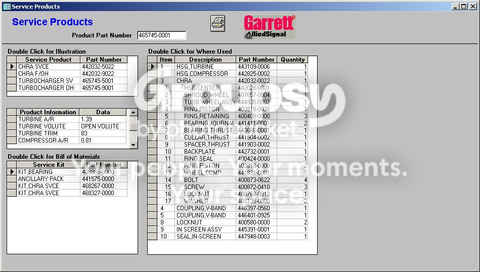

Sean, I post the complete parts list for your turbocharger.   You can order any part for your turbo at any Garrett turbo dealer.   If you can read the info off your data tag (located on your bearing housing) we can then confirm what you have.   That A/R for your turbine housing will be stamped inside the turbine housing inlet.  FYI the 400HP engine uses a 1.23 A/R turbine housing.   Everything else is the same.

Thanks for the very complete description of the fix, as well as the parts list.  I have to confess, I am nervous about tackling this -- I know the tolerances are very precise, and these things spin horrendously fast with incredible forces involved.  Of course, someone with the handle "zero clearance" probably thinks these heavy-duty Garretts are "sloppy" Smiley

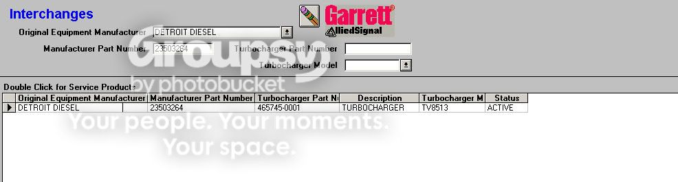

Sean, this shows the factory Detroit cross to the Garrett part number.   Garrett is the OEM for the Detroit.
Thanks for posting the part number from your tag, it confirms all the parts given up above.
