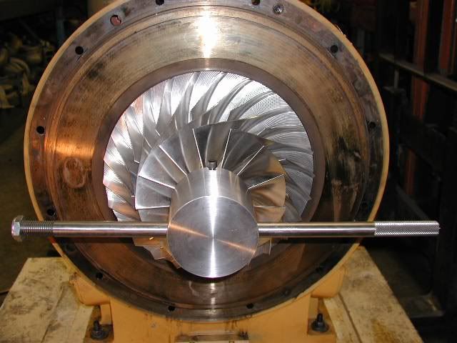

Since Clifford mentioned his CAT "hardware"..     This is the largest CAT turbocharger to be installed in the US.   I was the first person to rebuild one.  The new Cat 3600 series "6 cylinder" was a repower on a Coast Guard cutter.   This new Napier failed on sea trials.   The boys in the engine shop forgot to remove the oil drain plugs (red plastic plugs)..
This turbocharger has a solid billet compressor wheel that spun on the turbine wheel without a nut.   The inducer smallest diameter of the compressor wheel measured around 9".   I had to manufacture all the tooling to take this unit apart.   The repair manuals weren't even written yet.   This is one large turbocharger.   What you see is just the center section or cartridge.   It's on a 48" pallet.   The breaker bar that I made was 42"
Back to the OP,  this unit was all sealed up in safety shielding/blankets, the turbo itself was water and oil cooled.   The shielding blankets are very impressive when installed on these large marine engines.   I requested that the CAT tech's not install the blankets until the turbocharger had been broken in..    I strongly recommend that folks that do install new turbochargers "wait" for awhile before the blankets get reinstalled.   Heat cycles make it or break it for your turbochargers health and long term performance..    Yes, it's easier to break everything on a engine dyno or load cell, but to mimic this in real world conditions it does take some time to get the turbine seals to seat.
« Last Edit: December 01, 2009, 10:37:41 PM by Zeroclearance » Logged
