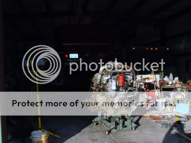

Rick this is the best shot of the one I borrowed from Gary at BB coach,It is expand able to allow for an 6V or an 8V to be cradled, bottle jacks at both ends to lift the engine off the rails.Goor luck
