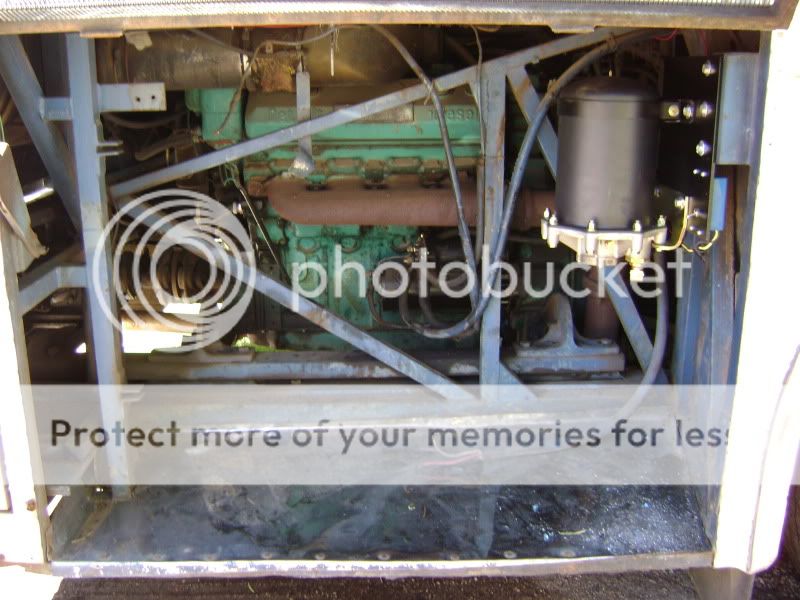

« Reply #9 on: January 20, 2010, 06:24:39 AM »
This is where we installed one on our 01 Eagle. I know it's an MCI thread but it's still a drier install.
Not sure where in an MCI you can mount it, just food for thought.
The air line come out of the compressor, over to the ping tank on the opposite side then back the the drier. I installled a switch for the heater with an LED so I can see it if it's on, that is if I remember to look!
Posts: 9852
« Reply #10 on: January 20, 2010, 06:32:07 AM »
Eagle has always mounted the air dryer in the engine compartment without problems.
Mine is on the drivers side at the back on the 05 close to what Paul's setup is and easy to service.
Model 10 and 15 are in lower corner of the passeners side.
