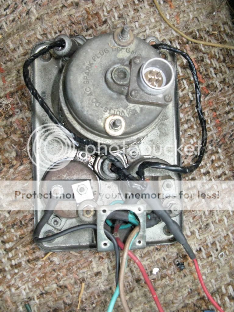

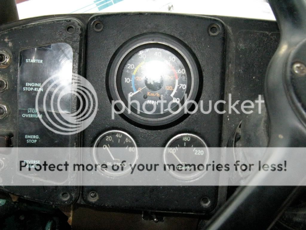

As I continue to sort out the wiring other road blocks appear.

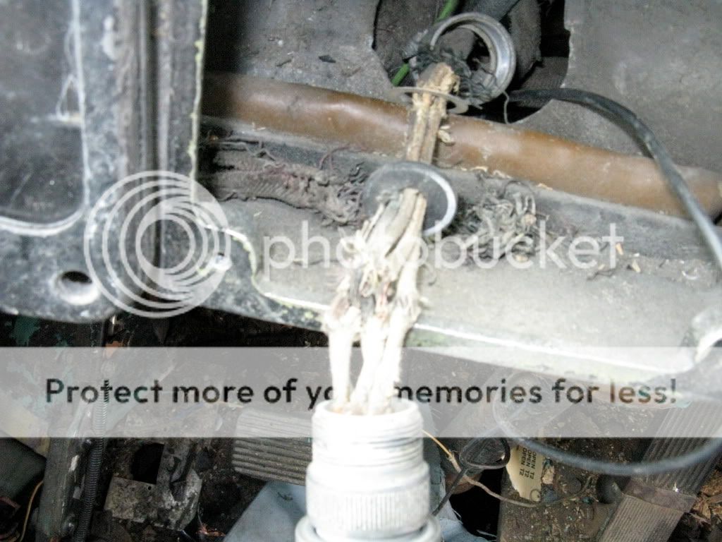

This is the multi pin connector for the main gages in the dash ( temp and oil).
It may not be clear in this almost in focus pic, but the wires are all frayed and shorting with each other, if you don't know how to open these plugs, this is what happens, PO seems to have  twisted the hell out of this harness.
I cleaned up the frayed wires by crimping on and heat shrinking new wires.

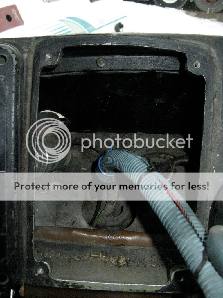

re did the back of the panel as well
and while I was at it installed the new speedo.

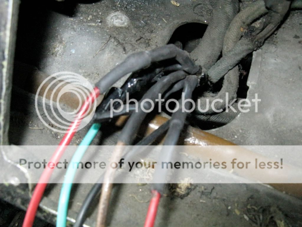

this is the new harness I made to replace the frayed one

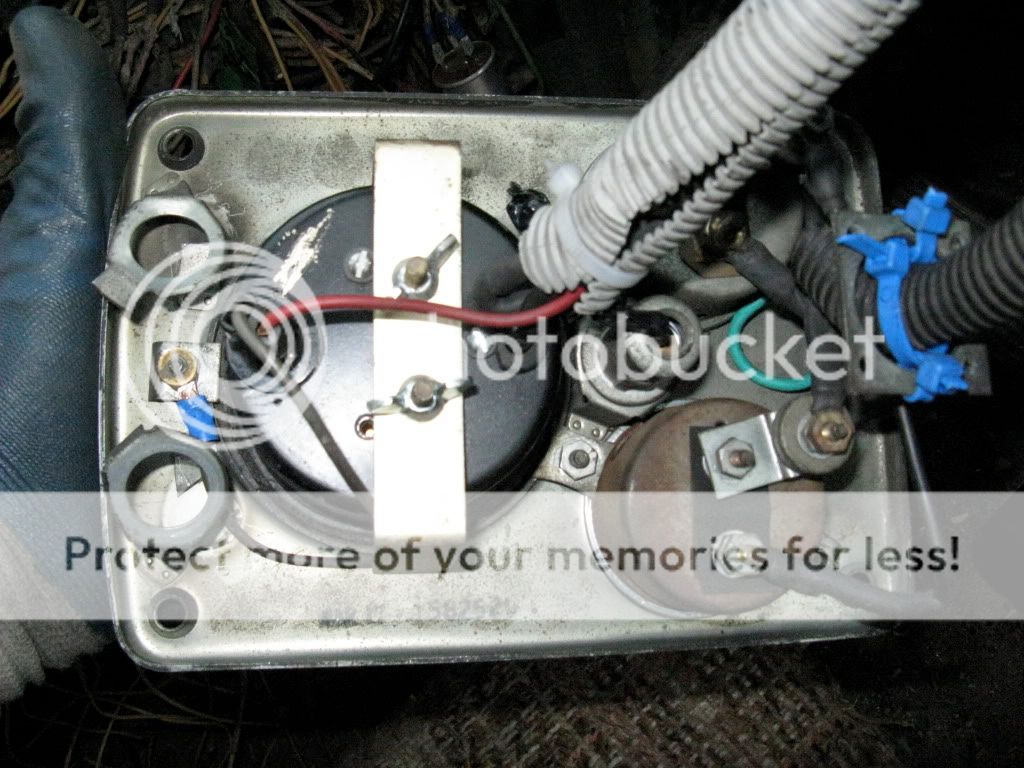

and this is the way the new speedo looks in the dash.
Not as nice as the original, the colors look cheesy, maybe I'll fix the original.

« Reply #3 on: March 19, 2010, 01:13:24 PM »
Zub,
Whats the green wire in the 5th picture not attached to anything? Did you vacuum out in there before you put it back together  Huh

« Reply #5 on: March 19, 2010, 05:53:53 PM »
Yeah its the harness that was frayed and shot, I could have made 2 splices on each wire , but that would have been 4 splices more, and  all on rough wires.  I actually really like the plug system they use on these buses, the other ones in the dash are still good, hope this is the only one I have to bypass.
Zub,
Bryan
That is one of the PO's mystery  wires, it went to the speedo but then at control panel it is loose, possible spare for the future, good eyes.
I wish I was done and ready to button up, the shop vac hasn't been by for awhile, maybe time for a visit.

« Reply #6 on: March 20, 2010, 11:09:53 AM »
Zub,
Ok, just thinking it might be a hot wire. Hate for it to ruin your hard work  Wink
