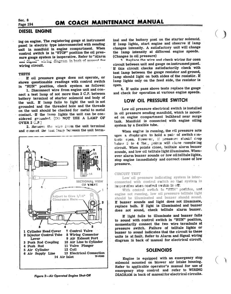

Thanks Chris , about a week ago I was really lost...pretty much up to speed on the wiring at this point....mostly the fuss pot in me that wants to get all the tell tales working.  I've got the basics under control, temp, oil, air etc...  I even drew a 4 relay schematic to replace the alarm thingy (which has been removed from my bus) so that I can have a over temp/low oil/low air/ rear door alarm buzzer.  Really are more serious things to do but I'm feeling electrical.  At one point I seriously considered just running new wires from the rear junction panel to the front one, but as the existing wires seem intact I'm sticking with them...oh actually I did post this elsewhere but if you know a quick fix for the #8 in this illustration I would be glad to hear it, was hoping to tidy that up tomorrow, My #8 has fallen apart.
