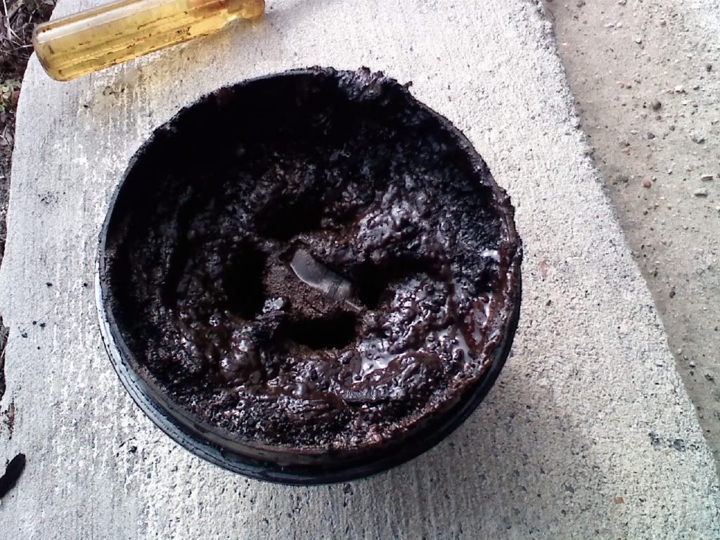

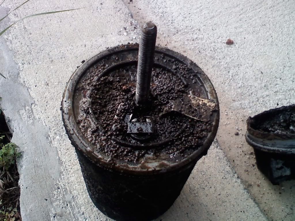

I think I can finally post a pic of what the inside of my dryer cover looked like at the purge valve. no telling how long it was never attended to.
txjeff
Posts: 119
« Reply #31 on: June 18, 2010, 09:02:05 AM »
thats nasty..........I guess I better service mine since the PO didnt look at stuff like that. I see you got the pics to post....

eddiepotts
Posts: 446
« Reply #32 on: June 18, 2010, 09:07:13 AM »
I went to the test area and tried. It's about time Grin
Posts: 3921
« Reply #33 on: June 19, 2010, 07:34:21 PM »
Now the only concern is did the current compressor pump that in there, or the one before?
Monitor what is being blown out the exhaust on the air drier, this is a fine warning that the compressor may be pumping oil.
All part of the restoration efforts!
