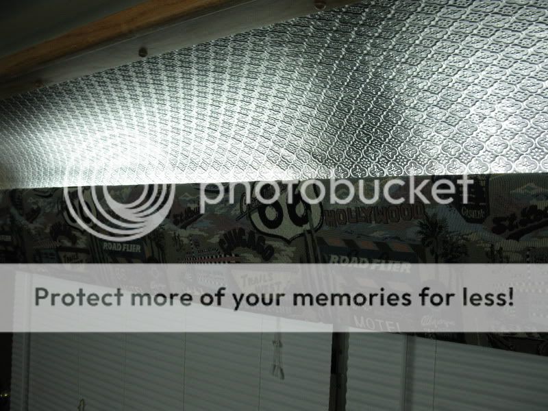

« Reply #14 on: September 09, 2010, 04:18:35 AM »
This is what we used on the curve of the ceiling, the 4' center section is white tile board. It gave a good contrast. The tin look comes in 24" wide rolls, 25' long. We then used some plastic tin looking panels for the kitchen backsplash, those came from HD. Lowes has the same thing in many different colors.
