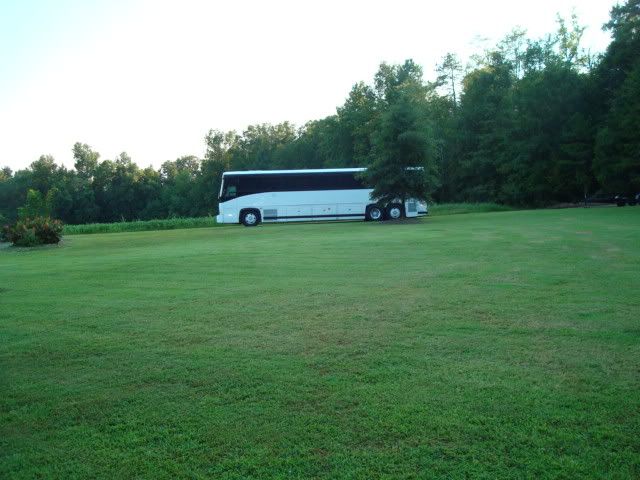

I've got an MCI that I purchased a couple weeks ago. I just noticed it doing something that it shouldn't be doing. The spot I park my bus on is on a slight incline. I've noticed twice that I've parked my bus and when I returned to it the next day, it had rolled 10 to 12 feet. The other time it appeared to have rolled close to 20 feet. I know for a fact that the Park Brakes were applied when it was parked. Also it stops while still on the incline so that leads me to believe when the Park Brakes malfunction that it is only for a few seconds before the brakes re-apply since it doesn't roll all the way to the bottom of the incline. I can hear a small air leak in the Park Brake valve when I shut the engine down so I'm wondering if that is where the trouble is. The bus does have other air leaks too but they don't seem any worse than most other buses. Does the air pressure hold the bus in place until it leaks down low enough for the spring brakes to hold???  Here is a picture of the incline my bus is parked on. That incline goes for approximately 200 ft but so far about 20 feet is the furtherest it has rolled.  Any ideas or advice??

Adjust your brakes and grease the DD-3 good then you will be fine,they get full of dirt and rust over the years and balls on the ratchets locks don't work to lock you probably just have one side holding

That looks like a fairly new MCI.  Do the newer MCIs have DD3 or spring brakes?
If spring brakes, I would suspect some brakes that are quite a ways out of adjustment.  As was noted, an air leak would not affect the parking side of the spring brakes.
Looks like an MC9 with a paint job and maybe some updated fiberglass.
DD3s. Probably needing adjustment and/or grease. Possibly in need of diaphragms.
