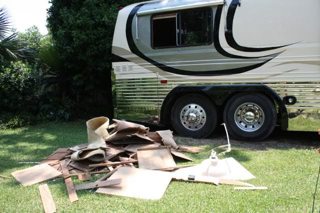

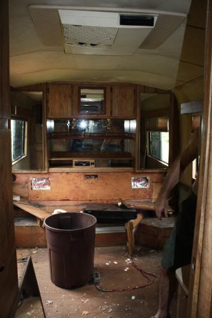

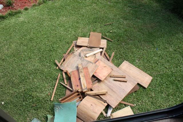

Current progress...
Brian S.
Brian Shonk
Fort Walton Beach, FL (Florida Panhandle)
1981 Prevost LeMirage Liberty Coach
1984 TMC MC-9

I just saw your pictures. You are doing a "major" update.  I like the back bedroom.  The bed in the center is
always in the way and never used.  I think this will be ideal for me.
Let me know if and when you have some time to drop by.

That is a major project there my friend.
Im looking to simply ditch the bed and end tables and put in the lounge sofa.
Some more pictures of the sofa...
