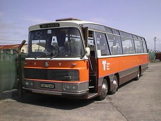

Yes, it's cool...but it's not long enough; as it is, most people (normal people, not Busnuts) would not look twice at it as it looks too much like a regular production coach (sure quad axles are unusual, but not unique). Having done all that work you want it to look really special, so make it as long as you can practically and legally get away with.
One of my own coach's antecedents is the Bedford VAL, as made famous in the 'Italian Job' movie. They are very collectable over here - there is certainly something very cool about having twin steer axles
