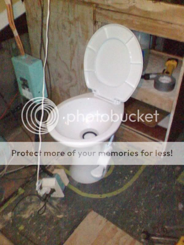

« Reply #22 on: January 27, 2011, 05:32:19 AM »
John, FWIW we just installed a Dometic 310 and am very happy with it so far. $145  locally @ JW RV Vegas, took all of about 15 minutes to install, like with any toilet, watch out for the freezing temps. good luck!

« Reply #23 on: January 27, 2011, 08:34:35 AM »
Van I guess that is  temp set up eh. If constipated, just grab the electric wire to shock the $#%& out of you? LOL

« Reply #25 on: January 27, 2011, 02:34:41 PM »
Lol! Dave no need to grab hold, it is a plug in sort of affair Grin Grin
