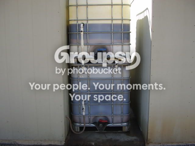

just for info a pic on two of my settling tanks!!
you can see the difference between the pure clear oil on top and the settled shortning and water!!

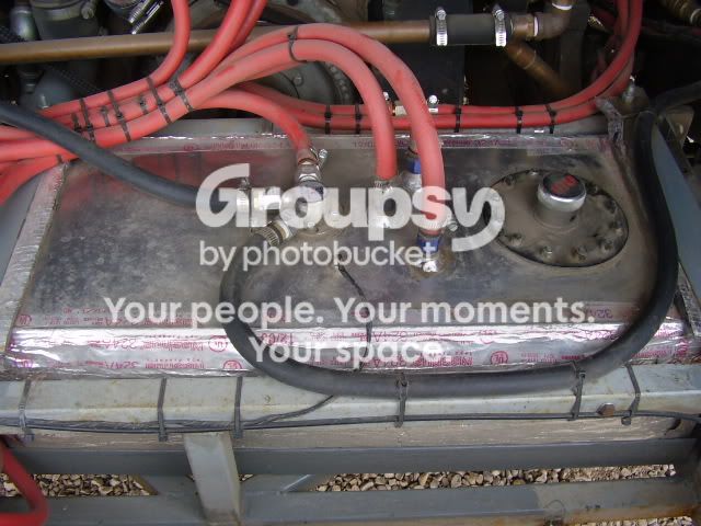

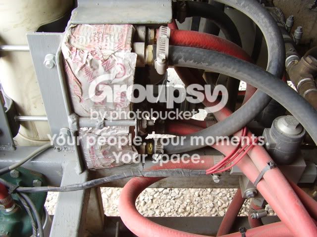

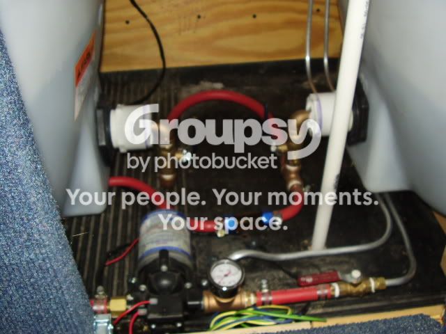

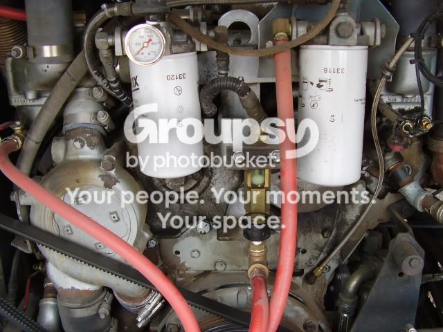

just some key pictures of the parts on the wvo system in my bus  Smiley
wvo surge tank in engine bay , with heat exchangers and fuel valves
