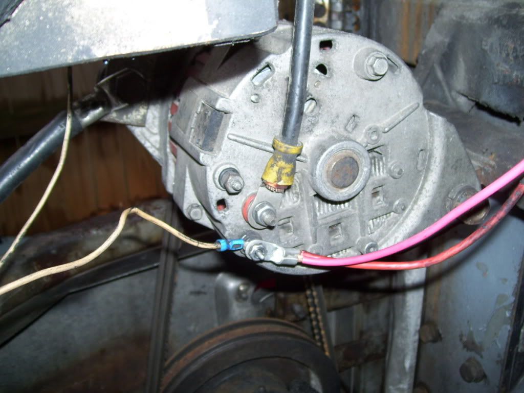

I picked up the bus from Williams and now the alternator is not charging.  There is no dash gage, so it took the systems getting weak for me to realize it.  We took the alternator to an alternator rebuild shop.  They tested it and it works fine.  The only question would have been the voltage regulator, so we had them replace it ($30).  Reinstalled it and it is still NOT charging.  Absolutely nothing.  Just running on battery.
We checked the wires going to the alternator and there is no voltage coming in.  I am including a picture of the alternator.  It is 12 volt as the entire bus is 12 volt.
The wires lead to different relays and I do not know where to look for the problem... Ideas?

It looks like there is an unused terminal on the back of the alt. What's it supposed to do?...Cable

I have No idea.  By the way, ignore the newer of the two red wires, we ran that one as a bypass (to no avail).

With alt. installed, does it have 12v at any terminal on it? Or is it not being excited...Cable
No 12 volt going into the alternator.  The wires read dead.

I think it needs to be excited.( 12v to alt). Can you run the gen set to charge the batts while on the road? Might get you home to friendly territory...Cable
We are safe and sound here at Gary's and he has more privacy than we do.  I did run the genset to keep the batteries up enough to get here.  But I'd rather fix it here before driving it any further.  We will probably go home in the car and deal with it next week.

I just looked at mine. It is a delco. I have 1 lug for the tach and1 for my main. My main runs to the hot side of my soleniod. It should be a prett short run to trouble shoot. Where is your main line going. I do know that mine takes a few miniutes to start charging.

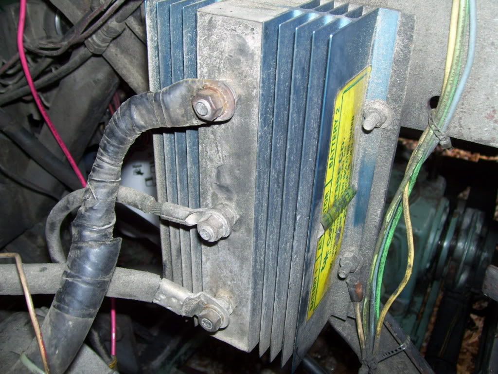

I notice you have a battery isolator.  have you verified voltage at the isolator?  A failed isolator will prevent you from getting any charge.
There are three kinds of people in this world....those that make things happen, those that watch things happen, and those that just wonder what the heck is happening. Which one are you?
1977 MCI Crusader MC-8
8V71N/740
95% converted (they're never really done, are they?)
thejumpsuitman
Posts: 750
'79/'97 Eagle 05
« Reply #10 on: March 30, 2011, 05:24:35 PM »
Nothing at the isolator, but I figured since there is no 12 volt going into the alt, that it is not a surprise..

What if I just run a new lead from the hot side of the starter solenoid to the alt?
"Life is like a game of Pool... No matter how bad it looks, you take your shot."
fe2_o3
Posts: 566
« Reply #12 on: March 30, 2011, 05:29:34 PM »
That should excite the alt. if you connect to the proper terminal...Cable
