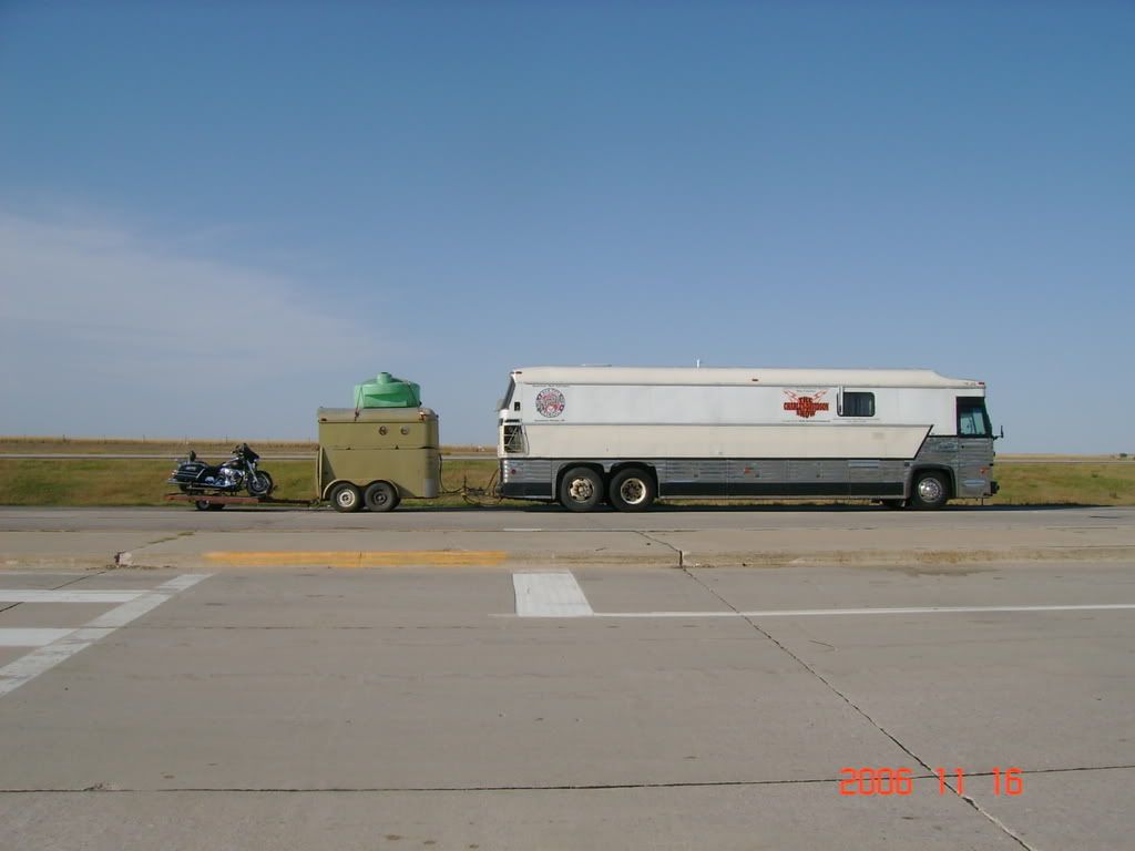

How big is the trailer your pulling the car on? You could carry some oil on the trailer with the car.
 Here's what I did on a Sturgis trip
