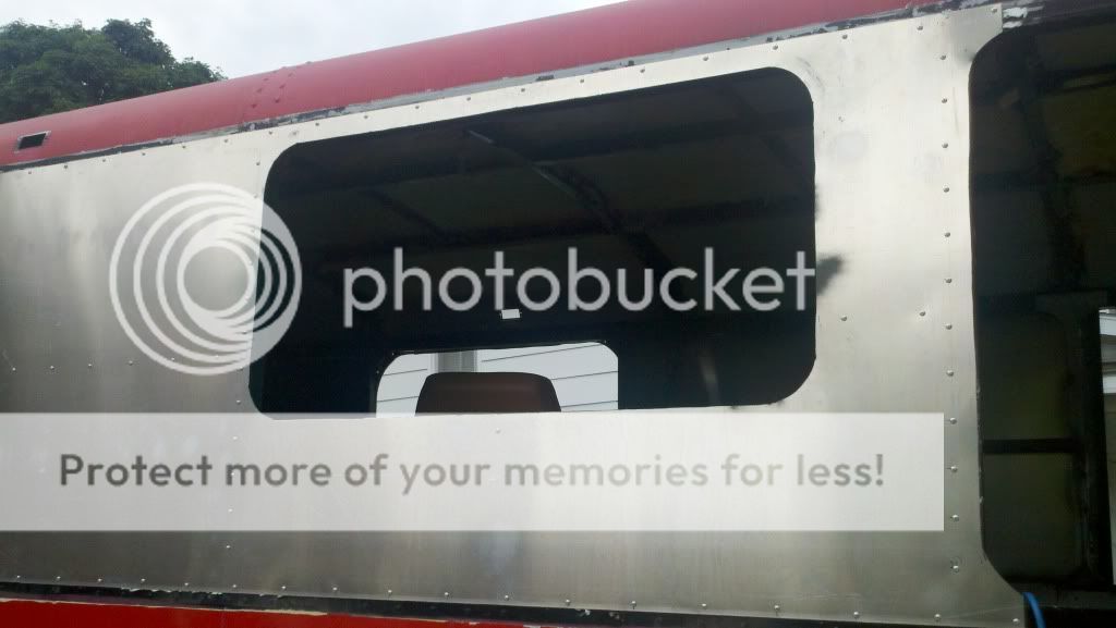

Well, I ended up using my side grinder with a very thin cutting wheel.  I used the jig saw on the corners to cut the curve.  The jig saw was fine, but went through about two blades per window.  With the grinder I can do almost one window before changing wheels.  But, in the end, the side grinder gave a nice smooth cut.  It did heat the aluminum and stretch it, but when it cooled it went right back.
1989 MCI-102 A3
DD 6V92 Turbo, Alison
Tons of stuff to learn!
Started in Cheboygan, Michigan (near the Mackinaw Bridge).  Now home is anywhere we park
http://dave-amy.com/
« Reply #26 on: July 08, 2011, 06:05:29 AM »
looks  great      next!
