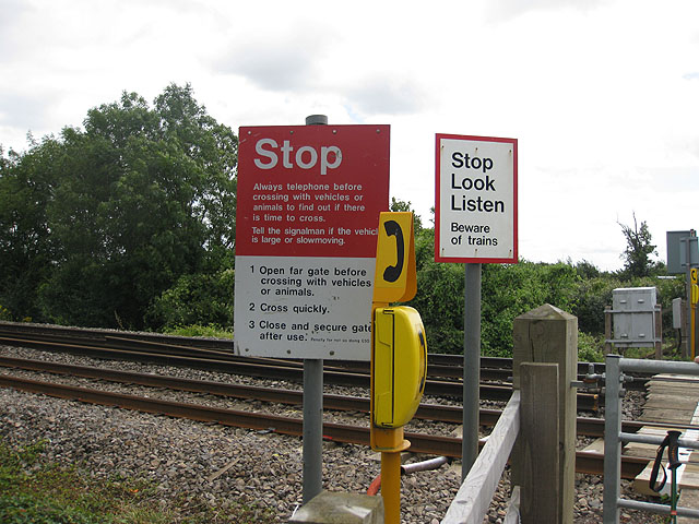

Just for interest - when trains crossings here are on minor roads in rural areas and don't have automatic barriers, a 'phone is provided beside the crossing to warn the signalman (despatcher) in case you are likely to be slow across the tracks
