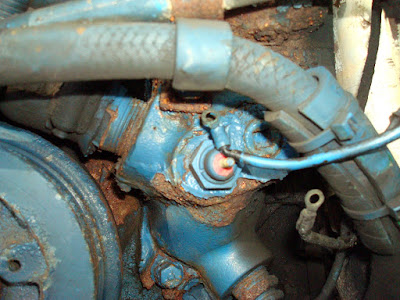

uemjg I already have the those gauges with the exception of trans temp. And I'm glad I have them. I think I'll try the boiling water test for the alarmstats. I would like to know if one or both has gone bad. Here's a list of questions:
1. There are two correct? If one of them trips, but the other doesn't (because one is bad) would that still trip the alarm and shutdown?
2. I am posting a few photos to show where the exhaust came off. It is literally blowing hot exhaust gasses inches past a large copper coolant line. Could this be the cause of the overheat alarmstats going off?
3. What is involved in having a mechanical (v.s. electronic) temp gauge installed for the dash gauge so that my most accurate readings are at the dash not in an engine bay (pretty useless when driving down the road).
Here are photos of where the exhaust separated as well as photos of the disconnected alarmstat wires:
Scott & Heather

That is a sending unit for the temp gauge not a alarm stat

I disconnected three wires. One on each of the stat sensors (those photos indicate two different stats) and another wire that you can see in the second stat photo (it's hanging loose to the right of the photo). One of those must have been the alarm stat shutdown wire right???  Huh

All the 1 post Kysor  alarmstat I have been around have a 1in+ body hard to tell from your photos but you can start the engine and ground 1 wire and it should shut the engine down if it is a alarmstat

In stock trim, in this vintage, these engines will have three of these temperature measuring devices, with one wire each.
An alarmstat in each thermostat housing, which will ground if the magic temp is reached, triggering the hot engine light, and the auto shutdown, if so equipped, and one side will have a second sensor that is connected to the dash temperature gauge.
Often, a busnut will make provision to install the second sensor for another temp gauge in the off side, to monitor the temp out of each bank. Why? Well, because we like to know these things....
Whether that pipe break influenced the temp sensors, well, maybe not... it will definitely have made the whole engine room hotter generally.
It would not be a bad thing to swap the alarmstats out for new ones and call it preventive maintenance? Consider pulling fresh wires for them...
