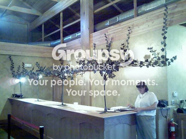

By the way, it's a bad pic (taken with my phone) but here is just a small sampling of the "steel vineyard" over the tasting bar at the winery. Thought maybe you might like to see it. I still have to do the grapes.
Thanx again!
