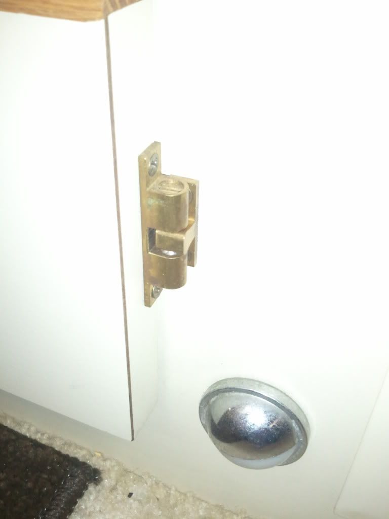

« Reply #19 on: July 26, 2012, 08:04:20 PM »
This is the latch that Newell used in the 80's. You can adjust the tension with the screws top and bottom.

« Reply #20 on: July 27, 2012, 06:56:49 AM »
We used these latches but got them from a local kitchen cabinet supply house for $7 each. I have one on every door and drawer in the bus.

Posts: 3414
« Reply #21 on: July 27, 2012, 12:49:38 PM »
I have a whole (dozens) bunch of this type:(lower right corner ones cept mine the actuator buttons are square not rounded).
And in certain places the "Newell" type never had a failure....now the referidgerator..that gets a double bungeee....it can make a horrble mess...

Posts: 2704
« Reply #22 on: July 27, 2012, 02:46:05 PM »
I have two small doors that have the Newell type on them, never looked at them that close, never knew you could adjust them. Grin
