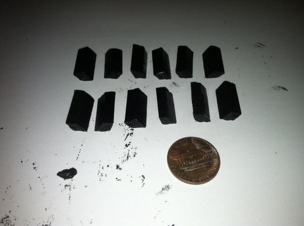

« Reply #22 on: September 27, 2012, 10:04:32 AM »
Well - not out of the woods yet - ran with little smoke the last couple weeks - but got white smoke again
i think the injector issue was a symptom of something else
while running i noticed the same leak as last time (raw fuel coming out of exhaust manifold connection to exhaust pipe)
so I popped off the airbox cover on the cylinder that got the new injector and found what is pictured below
12 similar shape and size metal diamond shaped pieces
they look broken from a rod
I looked through the dd v71 manual - engine section and couldnt find anything remotely close to this shape
what are they - where did they come from?
im confused and praying this is a repairable situation

« Reply #23 on: September 27, 2012, 10:51:26 AM »
Parts from the injector,buy a cheap bore scope from HF and look inside at the top of the head it is repairable exchange head and a piston and liner kit I feel for you but I tried to tell you

« Reply #25 on: September 27, 2012, 02:12:47 PM »
If those pieces were laying inside the air box out side the cylinder ports and not inside the cylinder your blower probably came apart

« Reply #26 on: September 27, 2012, 03:48:10 PM »
Those parts came out inside of the air box cover. they were stuck in it with all oily goop.  I look inside of the cylinder with a bore scope and didn't find any significant marks or scratches or scuffs.  I am pulling out the injector right now to use the borescope going to look at the top of the piston.  Looking at the exploded view of the C 60and injector I don't see where these particular parts could have come from.
Blower parts...ill check that ... suggestions on isolating blower parts?

Posts: 3620
« Reply #27 on: September 27, 2012, 04:18:57 PM »
They sure look like gear teeth to me.

« Reply #28 on: September 27, 2012, 04:21:41 PM »
Okay, I been having to wait 2 minutes to load every page off this website.  Ready to give up.
Looking at the picture of the penny with the broken pieces I say they are liner ports.
Time to pull the head and put a new kit in that hole, if everything else is okay.

Posts: 18744
« Reply #29 on: September 27, 2012, 04:24:28 PM »
While you have the injector out run a compression test if you don't have 350 to 400 lbs running at 900 rpm on the test it's time to slip into your coveralls
