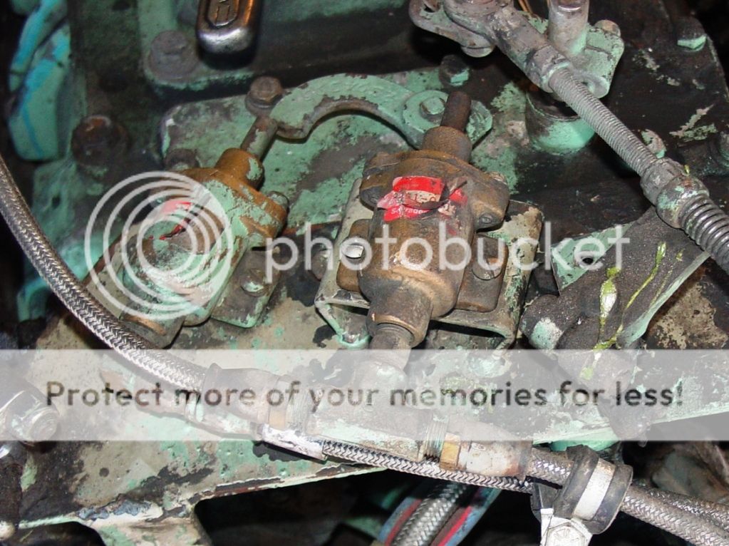

I have a 1977 MCI 8 bus with a 8v71 engine and all of a sudden wont start.  My first guess was the shrader valve is stuck...see pic.

Your 1st guess is right on it now find out why most of the time it is electrical check the rear start switches for the right position and go from there to the skinner for a hot and ground sounds simple huh

Well it had to be the valve because I've never had an issue starting and the valve didn't "look" correct.  So what caused or causes the schrader valve to be stuck?  In the picture is it "open" or "closed"?

looks like in the shut down position to me with plunger out that far just undo the air line supply to the valve and see if it comes back to the fuel position and starts

Whenever mine gets sticky I just wash it down with my favorite brand of weasel piss.  Silicon, PB, whatever your pleasure it will likely loosen up.

 All air has moisture in it,, after setting for some time the piston can corrode and "stick" a shot of lube and some movement will get you going till the "next" time.>>>Dan

I had a similar problem recently.  Do like Cliff says.  Even one better, just take the whole valve off as you'll need to clean it anyways.  Once it's off try starting it up. If it starts right up you'll know that's the problem.  Just make sure you have a way to hit that kill switch with the valve off or a way to cut off the air to the engine or else you'll have to wait until she runs outta fuel Wink

I keep a 14-inch stick handy to reach between the miter box belt to close the shut-down valve. I keep it on the interior ledge of one side of the back doors. Sometimes you just have to kill the engine before sufficient air has built to actuate the shut down piston. Incidentally, there are several reasons not to reach in there with your finger.
     If you'd like to replace the electric-over-air piston, I got one a few years back from Mohawk in Illinois - not too terribly expensive.

Well it was the schrader valve...lubed it and moved it bacl/forth manually and bus started up.  THANKS to all for the replies!

Just to make sure that the search engine can find this thread:
A Schrader valve is a tire stem valve.
I think the part you are talking about is the cylinder that activates the fuel shut off shown here:
Those cylinders (fast idle and fuel shut off) are activated by skinner valves.

Sounds like a possibility the dog bone is striped, check to see if the blower / fuel pump is turning.

Schraeder made many valves.

Those are made by Schraeder but I call those cylinders doesn't make much difference what they are called to me.
It's been awhile since Jim worked on a engine without a Pro/Link the other cylinder is a holding cylinder not the fast idle Jim

Ted, you could easily be correct, but it appears that their primary product is tire valves:
http://en.wikipedia.org/wiki/Schrader_valve
Clifford, you are correct, my main experience is DDEC.
It sounds like schrader makes the cylinder.  If that is the case, my comments really confuse the issue.  Sorry
