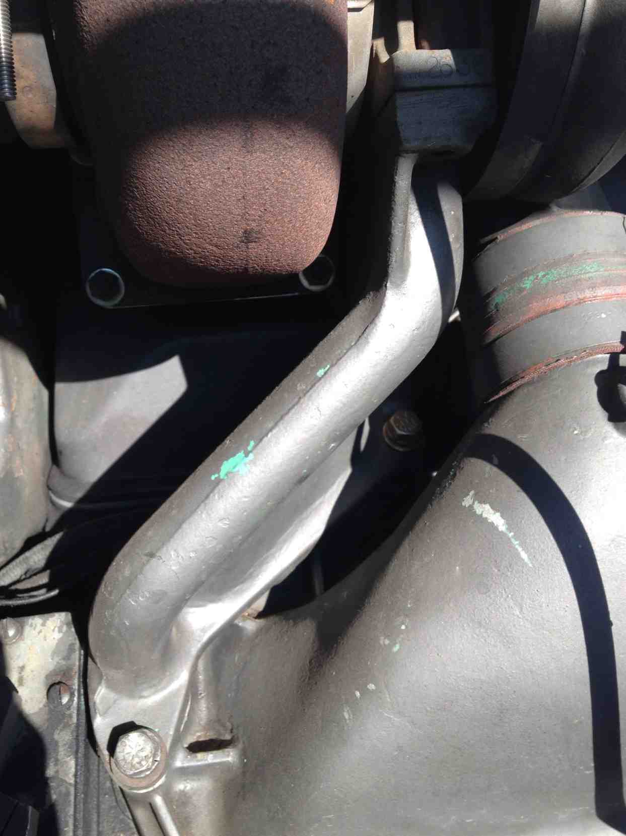

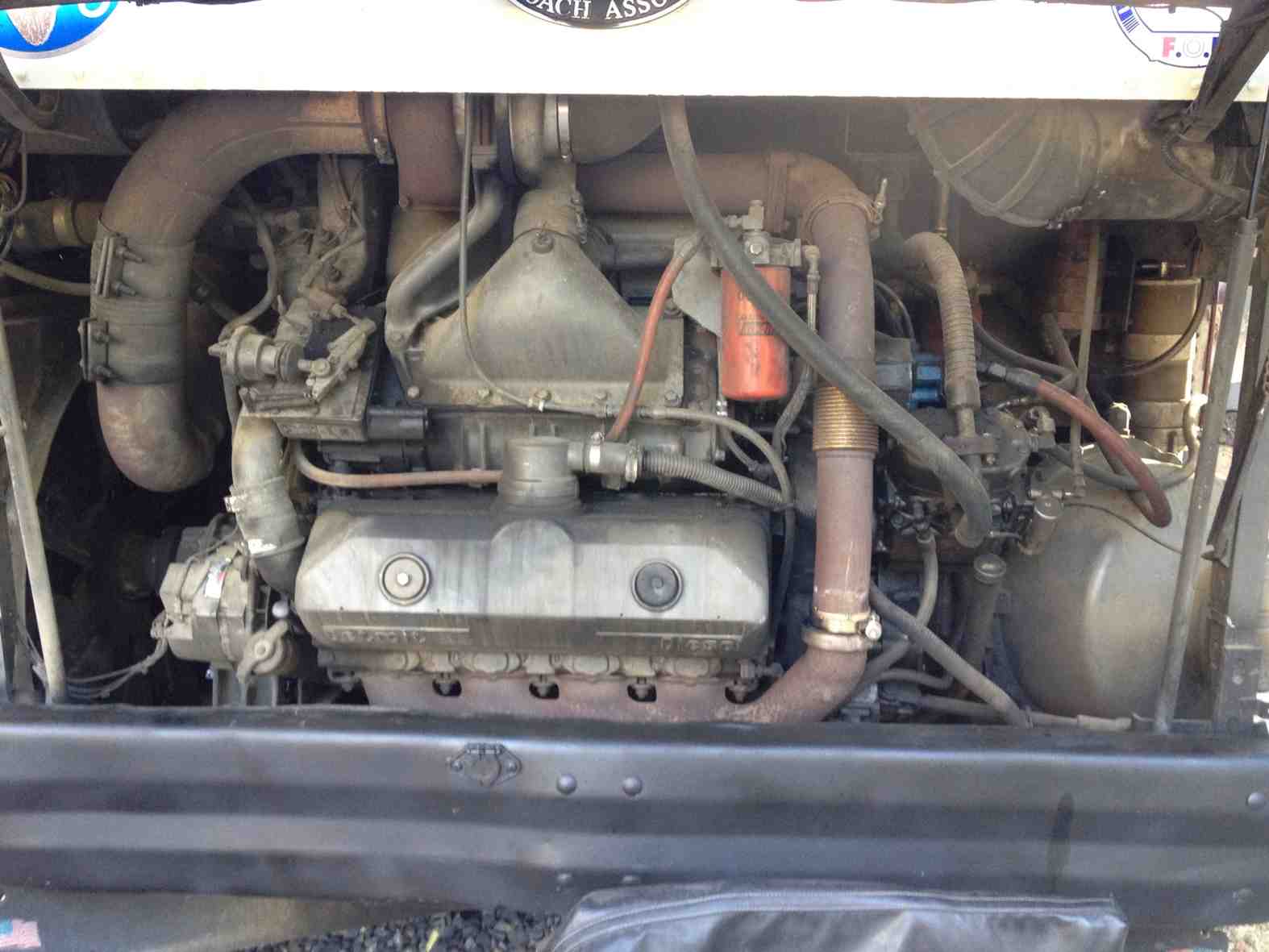

I have an 8v71T in my 4107 and I like it.  The plumbing isn't messy, and seems like a factory setup, from what I don't know though, PO did it.  Don't forget you have to re-plumb your exhaust and intake (see pics to get an idea) and you need the turbo horn and bracket that goes on top of the blower.  I think it *will* fit in a 4106.
Happy to get out the tape measure for you and tell you how far it sticks up if you are considering the 8v71T option.  I think it's still underpowered in my 4107, but it should make your lightweight 4106 fly.  If you go down that road, make sure you have sourced all the parts first - my understanding from my mechanic is that some of the plumbing is hard to find.
Do you have jakes now?  If not, might be a nice addition while you are in there.

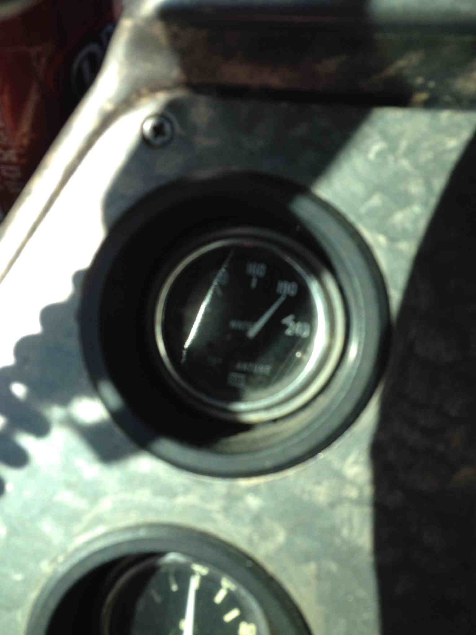

Ditto to what someone else said about getting the radiator serviced while it's drained anyways, especially if a turbo is in your future.  You might even need an upgrade in that area - I am wary of my temp gauge. Always looking at the damn thing, here's after a short maybe 2-3% hill climb (albeit at 60-65mph) on a sunny Oregon day:
I'm not ready to tackle a 6.5% grade at 90+ degrees OAT in this setup.  Not sure how many of us are, though - turbo or not.
Not meant to be a 6v92T vs 8v71T debate, either.  The '71 only has 16 more ci of displacement.  I've not driven a 6v92.  Either way, HEAT is always gonna be a concern.
