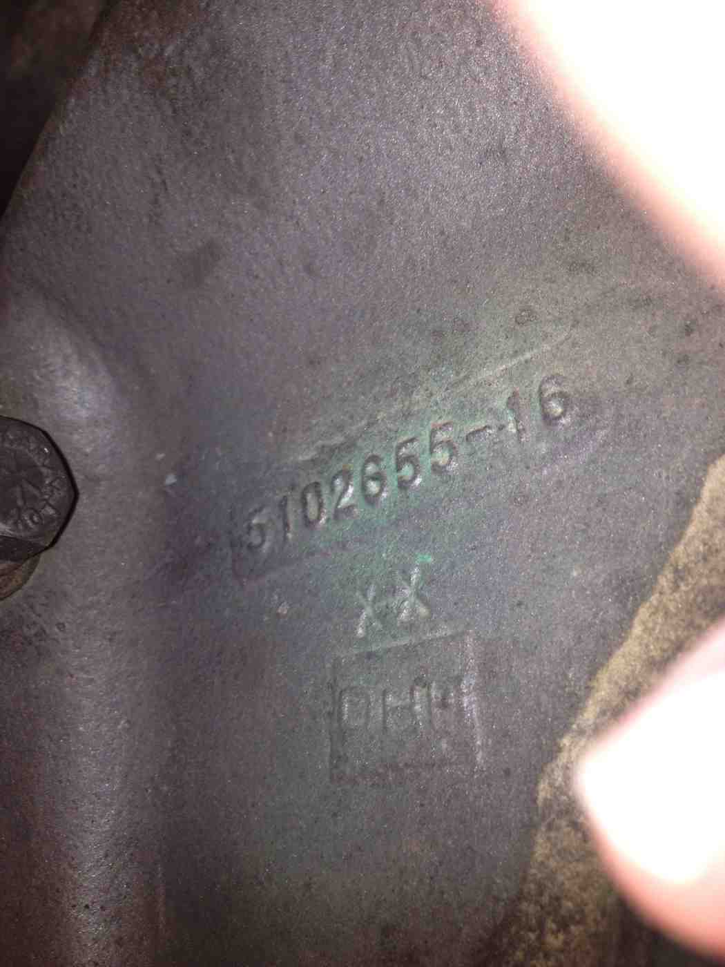

Clifford I have quick-release clamps on those exhaust pieces, my mechanic had that whole enchilada off there in about 10 mins.
Note my exhaust stack goes out the roof (unmuffled) loud as hell, I wouldn't do it that way if you can run it down and keep the muffler.
Here is the part number for that horn, I know you have one, is this the same setup used on lots of them or is this unique?
No more sawzalling unobtainium muffler parts!  I had to have a crappy muffler shop weld mine at 5:00 on a friday heading out on a road trip and I considered myself lucky to get a replacement pipe for $150.
