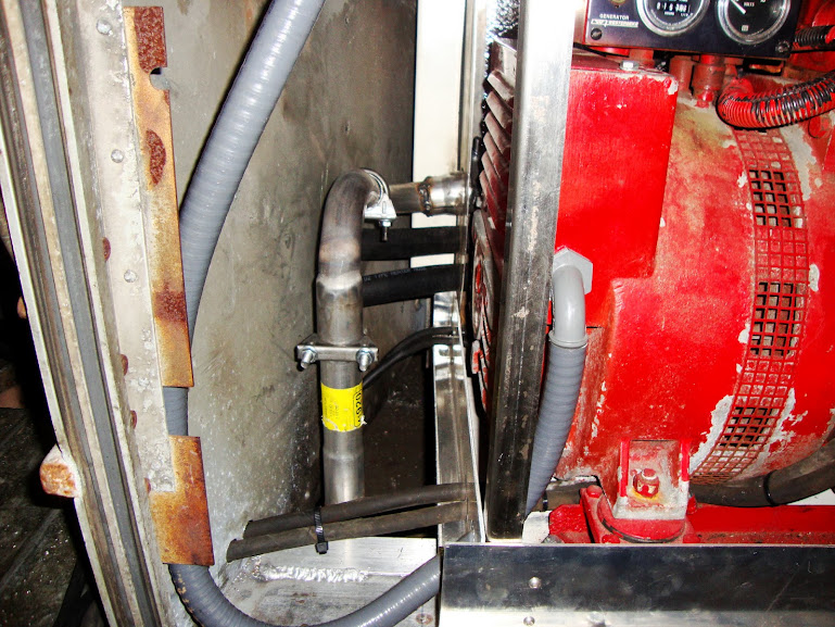

Since it’s been in the mid 90’s for last two weeks I decided it was most important to install the generator so we can run the two roof AC units over the road.  I have been collecting all the parts for a while.  The install went relatively smoothly and my measurements were spot on.  I needed to fabricate some fancy exhaust solutions due to the close proximity of the water lines, battery cables, fuel lines, etc.  I used 1.5” pipes and elbows.  I was stuck using a 2” muffler, no one had a 1.5” muffler in stock.  I had wired the generator for 240v and used it at my house during the last couple of major storms.  Ran everything in the house perfectly.  After I figured out a way to bleed the coolant (remote mounted radiator) the generator would not run both AC units!  One on each leg, each leg showing 126v, when the first AC would start the second leg would drop to 60-89 volts.  If I started both AC units at the same time, it worked fine until one AC cycled.   I decided to rewire the generator head to 120v.  I needed to move wires around in the circuit breaker panel to use one hot leg.  Everything worked fine on 120v, both ACs, inverter, fridge, etc.  Good to go.  Pulled 19.9 amps with both ACs running.

Is that SS Steel used to support the generator?

Hey Steve!  Yes, last summer we drove down to Chincoteague Island without AC.  "Never Again" was the collective consensus.  So... never again.  The Toad was fall back plan, too, but with 6 kids two were going to need to rotate!
I used aluminum, 4043 I think.  I used 60 self tapping 1/4-20 SS hex screws to anchor the plates to the far side.  It's extremely overbuilt.  That must be the endurance racer in me......
