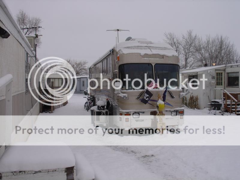

Yep. You were right. Adding windows to the prison bus comes at a hefty cost. Even though they are dual pane, we are only managing to keep the coach at around 65 or so with two space heaters now that we have windows. Not even T-Day yet and we have snow and 19 degree temps (F). We used to keep it nearly 76 degrees in here with two space heaters sans windows. So now, we are considering two toe kick heaters in kitchen, one in bedroom and one in living room as well as one in the drivers area which we curtain off. This would be just to keep the shoes from freezing and melt the snow on the steps. We'd go from 3000 watts of heat (currently) to 5000 watts. Hoping that's enough. Does anyone know if the Elkhart salvage yard has cheap toe kicks? $150 for a sideways electric heater is too rich for me.

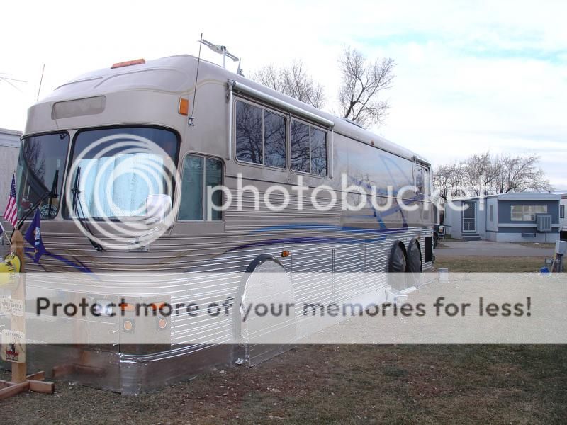

Scott one thing we did while living in the Eagle was to buy hard back insulation from lowes and fill the space between the ground and the bottom of the Bus as well as the wheel wells I also bought a bag of house insulation and put it under the steps and under the floor in the drivers area. I put  a small heater in the water closet on low.and one in the bay with inverter.

We liived like this for the whole winter in Billings with Temps well below zero (like -20 ) we were nice and warm but suffered from cabin fever more than anything Good luck been there done that  Grin
