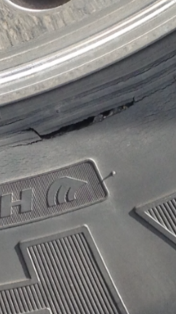

In September of 2008 I put two Hancook AH12 Premium tire on my tag axle. They now have 80,000 miles on them and are needing to be replaced. All the other tires are MIchelins and are three years old. I would like to put two new Michelins on the front and move the front tires to the tag. I contacted Rick Stewart with Action Tire Co. in March while I was in Georgia but Michelins were back ordered at the time.
I traveled about 90 miles Saturday and noticed that one of the Hancooks has developed a crack in the sidewall near the rim that concerns me. The Michelins I replaced three years ago were aging out and had stress cracks all over the sidewalls but nothing that looked this big.
I am in Salem, Kentucky just a little east of Paducah and I plan to leave here Thursday and drive to Gainesville, Texas by Saturday evening. I would like to find a place that honors the PC Michelin discount program and replace these on my way out Thursday. I plan to skirt around the west side of Memphis then go through Little Rock and Texarkana then across north Texas to Gainesville.
I would like to replace these tires sooner rather than later because this new crack scares me. Any ideas on dealers in Paducah or along my route?

Nothing wrong with Hankook tires-replace with same.
Freightliner has dropped Continental tires and now is offering Hankook tires at a considerate less charge. My tire guy is so particular, he likes Hankook tires, but refuses to carry Goodyear-just to give you an idea.  Good luck, TomC

I have been pleased with the Hancooks on the tag but my plan is to put new Michelins on the front and move the 3 year old tires to the tag. With the Michelin discount through Prevost Community the Michelins are very competitive in price to the others.

Removed 6 year old cracked Michliens.  replaced with Hancooks 1 year ago.
love them.  on rj's advice went with the tallest tire they made.  made HUGGY very happy.

I'm a retired road doggy and I'm here to tell you that the tire in your pic is just waiting to kill you or someone else!  I have no beef with the brand--but that one is DONE!  I worked far too many tire failure related accidents with their associated mayhem not to put in my two cents worth.  Even if you have to buy a good used tire to give you time to work a deal on new tires it is worth it!  Stay safe

Good news is I made it home to Ohio. I set the tire pressure at 108lbs and drove 45 mph or less for 340 miles. It took me 9 hours including Cincinnati rush hour traffic. I have a tire here that I can put on before I leave again IF I can not locate two new Michelins to put on the front and then move the front to the tag. I stopped often to check the progress, kept my eye on the TPMS and prayed fervently. The crack did grow some but thankfully the tire held.

  Do you use any type of tire covers on your coach when not in use? Looks like uv sun damage. Usually cracks will be more prevalent on side that gets majority of sun. Covers and some kind of tire protectant with uv inhibitors can help.
