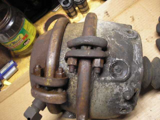

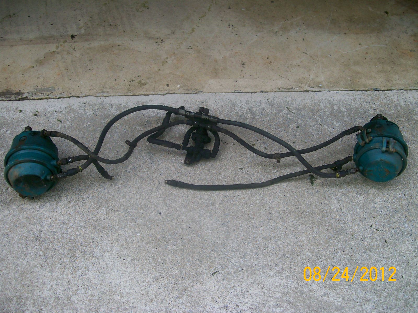

Posts: 3413
« Reply #14 on: June 11, 2014, 08:51:27 AM »
There are grease zerks on the DD3's I also doubt a relay problem
They are located here: tho covered with crap, you can see them, that are also left and right and there is an upside down that needs to be down to drain water and road krap.
On the left DD#:
Donald PH
1978 Model 05 Eagle w/Torsilastic Suspension,8V71 N, DD, Allison on 24.5's 12kw Kubota.
