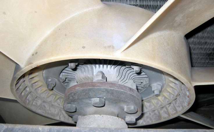

I'm stumped as well.  Here are a few guesses.
Before the rebuild you noted unusual heating.  With fresh engine now it tends to eliminate it as the culprit.  Same with fuel delivery and you were all over the filters prior to bringing into the shop.  Low pressure "should" have shown up at Pedco or Williams.  Bad load fuel- maybe, but I doubt fuel systems.
That leaves cooling system.  It's sure a long shot that the water pump is missing a vane or two resulting in lower flow.  They tend to work or not,  or work and just leak!   If it had a severed or freewheeling shaft it would seem you would overheat way before pulling a grade.
You have not mentioned if you are loosing coolant.  I bet not as this would catch you eye early on.  If the radiator cap was acting up and not keeping correct pressure, that would cause heating.  And also slowly loose coolant to evaporation.  Bet the cap is ok but cheap to replace and rule out ( is the pressure rating correct?)
Thermostat.  Possibility stuck.  Does it warm up at usual when cold?  If stuck it may take a little longer.  Longshot again, but cheap to replace.
My final guess-----fan clutch.  You said it pulls strong when idling, "can't stand behind it".   And it cools the bus down at fast idle during a hill climb.  Good.
The problem area is at speed/load its not transferring all the power necessary to drive the fan properly.
Only when you are asking for the max from the cooling system puts enough stress on the system to show the problem.  During city driving it still may be present but there is enough overhead in the cooling system to give the appearance of normal function.
*    Now if you don't have fan clutch please remove my foot from my mouth!!
**  Can't tell you how to test a fan clutch.
***Sean I have been so intrigued by your bus mysteries I think I will start reading murder mysteries again! Smiley
Good Luck!

Sean,
If by chance it is the thermostatic fan clutch, I have three that you can have for free when you're passing through this area.  Two were off my Skyliner and one off a Mega.  At least one should be good.  Might not be a bad idea to carry one for a spare since I doubt you'll find one at the local truck parts store.
Russ

« Reply #21 on: August 08, 2007, 08:34:47 AM »
Thanks, Russ, I will take you up on that.
Since you've already got them off, perhaps you can tell me if there is any kind of manual lock-up on them?  I can't see any, but it's hard to get to the back side of them.

« Reply #22 on: August 08, 2007, 08:46:40 AM »
They are at home, 50 miles away, so I'm relying on memory and that is aging like your cooling system; but as I recall there is a thermostatic coil on the forward side.  The housing is die cast aluminum and the blades some type molded plastic.  I never looked for any "fill" device, but don't recall any.  They attach with four bolts to the shaft on the opposite side of the v-belt pulley.  I think they come off without pulling the shroud, but can't swear to that.
They look like the thermostatic fans I grew up with on small block Chev motors, just larger and of course - being German they are metric.
I don't know their condition since I never ran this bus with the 8V, but since it was in operation shuttleing gamblers from Phoenix to LV in the 90's they have had about 10 years of R&R.

« Reply #23 on: August 08, 2007, 08:47:17 AM »
And no manual lock-up visible.

I hate to even suggest this after all you have been through but here is another thing to check:
Have a smog shop probe your radiator fill with engine running.  Hopefully it will not detect anything.  However, if it detects exhaust gases it may point to a crack in the head or block (or head gasket;but yours is new) which would also explain your heating issue. Ugg.
But, a cracked block will also slowly loose coolant and you have not mentioned this so I hope this is a dead end.
Still think its a defective fan clutch.

« Reply #25 on: August 08, 2007, 11:49:52 AM »
Russ,
From your description, it's not clear that we have the same fans.  In any case, I thought a photo would help the whole discussion, so here's my attempt at a picture of the fan hub/coupling:

Sammy
Posts: 523
« Reply #26 on: August 08, 2007, 01:53:17 PM »
Sean, with engine cold and not running ,spin the fan with your hand - it should spin freely.
Drive your bus to operating temperature, or more. Shut off engine (no disrespect intended), see if the cooling fan still spins freely. If cooling fan still spins with no resistance, fan clutch is NG.
Good luck.  Cool
Posts: 6009
« Reply #27 on: August 08, 2007, 01:58:32 PM »
Sean- that almost looks like a hydraulic fan hub.  Is there an air line going to it?  Does it cycle on and off?  If you have an air line going to it, usually the air releases it, so if you disconnect the air line to the fan clutch it should run continuously.  Good Luck, TomC
Sean
Geek.
Posts: 2530
'85 Neoplan Spaceliner "Odyssey"
« Reply #28 on: August 08, 2007, 04:21:37 PM »
Sammy -- The fans don't spin "freely" when the engine is off -- I can move them with my hand, but I feel resistance.  They won't keep spinning when I take my hand away.
And
Tom -- no air, hydraulic, or electric lines go to the hubs.  They are completely on their own.
I've been told these are probably viscous couplings.  They certainly feel like they are filled with some viscous substance.
Sammy, does that change your suggestion that I should not be able to move them when they're hot?
-Sean
http://OurOdyssey.BlogSpot.com
Full-timing in a 1985 Neoplan Spaceliner since 2004.
Our blog: http://OurOdyssey.BlogSpot.com
Sammy
Posts: 523
« Reply #29 on: August 08, 2007, 05:48:30 PM »
Sean, there should be more resistance when hot, don't remember if it actually became a direct drive - solid feel, no spin at all. Hope this may help with your troubleshooting.  Cool
