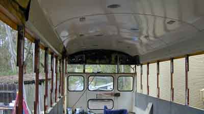

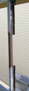

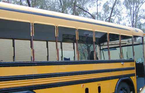

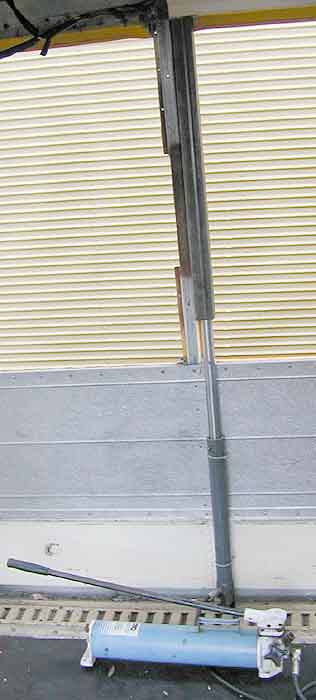

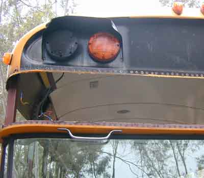

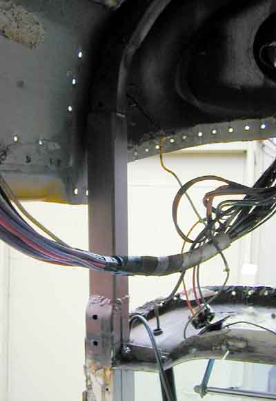

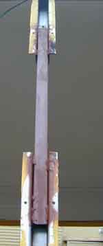

Here's some photos of my Bluebird roof raise two days ago.
The last photo is of the jack... simply a hydraulic cylinder with
a 2x2 tube bolted to it for extension, and a manual pump
For this bus I used four pieces of 1-1/4 heavy wall tubing held in with C clamps during the raise,
then welded in the same material to all the struts when the roof was up.
TOO MANY RIVETS! Yuck
